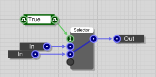

Postby strangeChild » Sun Nov 03, 2013 1:12 am
What's wrong with using the selector primitive? :?
strangeChild
Posts: 47
Joined: Sat Apr 27, 2013 8:04 pm
Re: Stream Router.
Postby Nubeat7 » Sun Nov 03, 2013 1:41 am
if i understood it right routing via the selector prim does a recompile of the code which has its issues in some situations (audiodropouts or crackles)
Nubeat7
Posts: 1347
Location: Vienna
Re: Stream Router.
Postby strangeChild » Sun Nov 03, 2013 2:11 am
I've used it extensively with audio steams and as long as the there are no discontinuities in the signal (i.e. the streams f(t) and g(t+1) are near each other) then there is no problem. If they are not either method will have a problem.
Edit = hmm was going to post 'proof' but there's an audible click where there shouldn't be.
I could have sworn this worked before. :oops:
strangeChild
Posts: 47
Re: Stream Router.
Postby strangeChild » Sun Nov 03, 2013 2:30 am
I think I've figured out when it's OK and not OK to use selector.
As long as the stream you're turning off is still being called somewhere it will work fine. If not there's an audible click as it shuts down, even if the new stream is in sync with it.
In many routing applications this is not a problem as the signal is still getting calculated. But I can see going with the coded variety to avoid the potential problem.
strangeChild
Posts: 47
Re: Stream Router.
Postby trogluddite » Sun Nov 03, 2013 4:41 am
It's often more of a problem with white poly streams than the blue ones - the switching has a nasty habit of resetting all the envelopes etc. of any playing notes (calls to stage(0) = code/assembly intialisation stage).
trogluddite
Posts: 1730
Location: Yorkshire, UK
