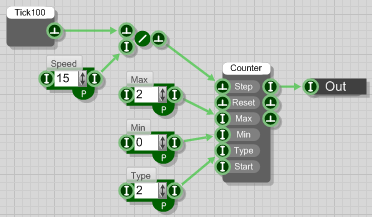

Ok ok, one last post and then i'll shut up, i promise
I got really tired of clicking that Selector dropdown. I mean, like, reeeeealy tired. So i built an auto selector
It can crash any schem from this thread except if KG_is_back's code snippet is used. I opened my revised delay schem which uses the code Multiplexer. Then I connected the auto selector and went to have a smoke. When i came back it was still going strong. The schem uses both Poly to Mono and Asio Out prims. I could play notes happily and toggle Midi/sound IO on/off with no problems at all.
