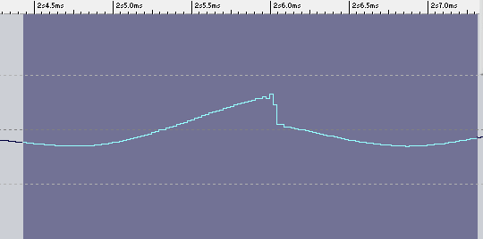

Re: How to eliminate 'click' problem?
Theoretically, but... Attached picture shows 3ms span with click if fade out is set to 10ms. So it's similar to what I did or the same.
I see following sources of that out-of-sync problem.
1) Either this has to do with some inaccuracies due hop within the source timer (made by fellow friend on SM long time ago).
2) Or it has to do with roundings in float domain (envelope clock performs some different calculations than anticlick, so maybe issue relies here?)
3) Or the phase shift applied to ine input - is delayed within the primitive
4) Or "changed" should be delayed between some of the routines.
So or else, you can hear it, and you can see it. What appears to be fade out - is about 40ms prior to the phase change if I see it correct (I can be wrong).
Possible theoretical solution. An idea.
"Changed1" is sent to that "fade out" timer. After output reaches zero - "changed2" impulse is sent from that timer module - to individual envelopes (and phase offsets and all other kind of stuff). Thus - there should be no rounding problems. Or? (...should be something else delayed by 1 sample?)
I think I have it worked out. I've recreated the envelope maker and the clock. Function-wise it should be the same but save a little CPU (there's still room for optimizations though).
The envelope and the click remover have separate clocks. The clock of the click remover has initial delay smaller by the length of the fade-out. This way the phase change happens exactly in the moment when the amplitude is zero. Only problem is, you can't change the fade length while the thing is running, because they get out of sync (clicking resync button fixes that immediately, so it's not such a big problem).
Fade in and fade out can be set separately. Envelope is exponential decay and is set by two parameters - TIME (in seconds) to reach certain RATIO (in dB).
Okay, it seems to work. Thanks for great work and time spent on it!
