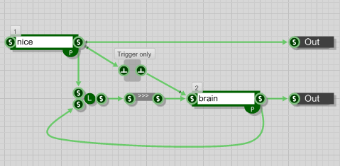

Postby MyCo » Sun May 17, 2015 7:04 am
Yeah I meant it like that. Sure it doesn't work, haven't thought about it thoroughly. The best thing I could come up with is attached.

Postby Perfect Human Interface » Sun May 17, 2015 7:17 am
MyCo wrote:The best thing I could come up with is attached.
That's actually terribly clever... The input is always the last thing changed so the second value can only "pull" itself. I think it's perfect MyCo! Thank you!
