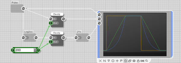

The dezipper will respond to a sudden change by linear ramping from the last value to the new value. If you have only positive values (=delay times) to consider and you want slower ramping for low values and faster ramping for high values, you could sandwitch the deziooer by a nonlinear function and its inverse, respectively.The screen shot below illustrates the idea fora log/exponential pair (both base 2):
yellow - input step function
green - plain dezipper
blue - sandwiched dezipper

Re: [Q] export does not generate valid vst plugin
would you be able to post that schematic Martin?
