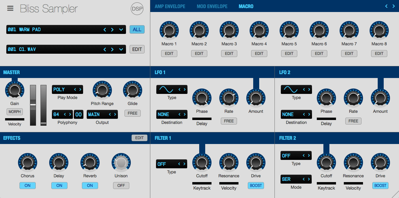

Last time I introduced you to building up areas using the golden ratio. Of course that's not the only option you have. Let's once again refer to the first two screenshots.
Charlatan follows the classical column/row concept, where each column introduces a new topic and each row is a subtopic of the column's topic. There is a variation, row/column, where each row introduces a new topic with the columns providing the subtopics.
For both the structure is from left to right and top to bottom. That is following the non-asian reading/writing culture.
Dune 2 follows the centered concept, where the important topic is placed centered, with all other topics placed around it, symmetrical as possible. You will find this type of layout a lot in commercials/ads. Within the sections, left to right and top to bottom is the structure again.
Here are some GUIs following those concepts (Note: I'm not saying those are all good GUIs, I just want you to see the concepts in use).
Centered:
GUI for a non-existing VSTi
GUI from Toxic Biohazard
GUI from Punch
Row/Column:
GUI from Oberon Poly 4
GUI from Bliss Sampler
GUI from MEqualizer
Column/Row:
GUI from Tal U-No-Lx
GUI from Limiter Nr 6
GUI from VR-08 Pro
Finally here's an example for a really ugly VSTi. Can you already tell why?
GUI from Harmless
More about this GUI in the next post...
