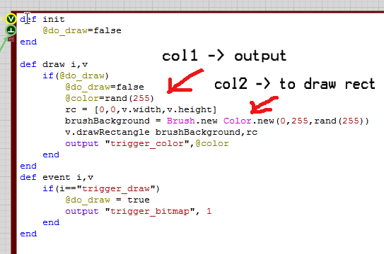

Nubeat7 wrote:Nowhk wrote:When you trigger, the color in the "current background" must be the same of the one in the generated "Bitmap", but that's not always true (or maybe: its rare that the two are the same).
sure, when you are using 2 different random colors, they will not be the same...
They are not 2 different colors

Nowhk wrote:They are not 2 different colorsI choose one (random), I draw the V and I send the color as output (to monitor it). The color is one.
2 colors!
