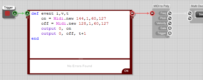

I've just see you had posted this message time ago, Tronic: "and then writes and reads continuously from memory"
It seems that outputs (the bridge between Ruby back to FlowStone) could run at different times from which they are called. If this is true, how can (for example) MIDI be sync internally of FlowStone when I create/manage/trigger them with Ruby (that is 100Hz accurate)?
I mean: if I generate a MIDI message and I stop it after 1 second:
Ruby MIDI Note On-Off.fsm
(8.01 KiB) Downloaded 908 times
who can guaranteed to me that it play exactly at time t and ends at time t+1? Ruby events are sync/scheduled to run at those fixed times, yes, but later MIDI will takes time to process/output to the following step (i.e. from my code to the input of Osc).
I know that every sample of type stream happen at correct timing, because FlowStone take care of this (following my not-proof idea about how FlowStone audio works); I think in the usual way of doing DSP using buffers: process data, create frames of samples and send them to ASIO (or trasmitted to the DAW that will treat them), but is this really true also with MIDI?

Tronic wrote:If the trigger is generated by a green, is not as much as it is ensured that the "t + 1", actually ends at "t + 1"
Ok sorry, I've wrong init point. Let says that the trigger is generated by a Frame (from mono to frame prim), at a fixed speed by DSP code (audio): Ruby events runs exactly sync with it (I trust this).
But what about MIDI (i.e. the part I'm interessed)? That's the point. I don't care if Ruby event execute in time, I care that what I create inside this task is executed in time :D
Once Ruby event run, to generate, manipulate and than send my new MIDI to the output (and than processed back to FlowStone/C++ again) it will requires overhead. Is it included in the Ruby/event time syncing this? :o

Is it normal that inside an audio development environment, MIDI (which is fondamental in audio) could be not sync? I don't believe in this... I think I'm missing somethings...
