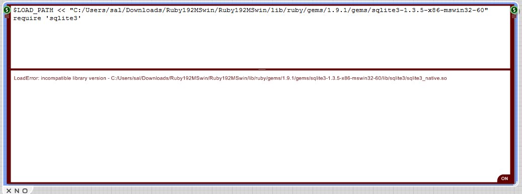

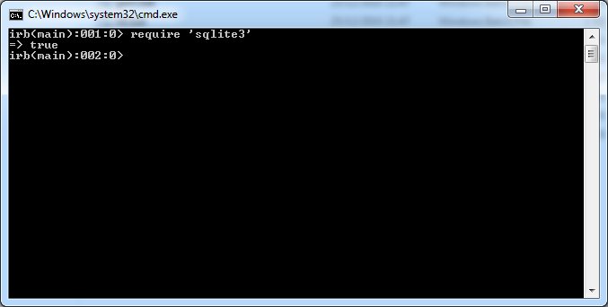

Re: Rubygems
thank you,
i did already try do change the PATH and my mistake was about my ruby version compiled with minigw, with the mswin version i can use some gems and i'm having problems with some other gems(the ones i would use) such as the sqlite3 and the mysql ones.
For example trying to require sqlite3 from irb it works, but inside flowstone ruby module it doesn't.
- sqlite3fail.jpg (34.5 KiB) Viewed 10142 times
