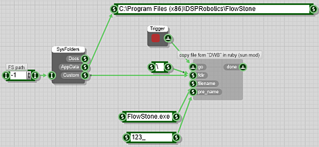

hmmm ... no luck getting this code working ... as yet.
Re: File Handling
Here u go...
Have Phun
Warning: Dest will be overwritten and path must exist...
Have Phun
- ...I think U need Admin rights because of ProgFiles path 4 this test schematic:
- copy file fom DWB in ruby (sun mod).png (288.42 KiB) Viewed 19217 times
copy file fom DWB in ruby (sun mod).fsm- (1.31 KiB) Downloaded 860 times
