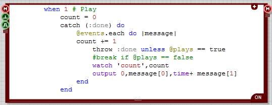

Well - now always these little problems...
I cannot exit this each do loop
It always run's until it's end.
The count shows immediately the max events.length!
It doesn't matter whether i use catch/throw or break...
Is there a trick with raising an error or something else?!
- throw or break doesn't work here.png (330.85 KiB) Viewed 19419 times
Re: how to send Midi Message
I'm not 100% sure, but here are some thoughts:
(1) break would have been sufficient. That both don't work, seems to point to '@plays' being the cause.
(2) each is a closed loop. It will be executed exactly at the time it is called. There is no connection to the external world (which means everything outside of 'when 1')
(3) if @plays happens to be an input, then .each will not be aware of any changes to the input until .each is done and Ruby is given a chance to peek at the inputs again.
(4) In case (3) is true, you need another way to loop through (for example scheduled inputs/methods), so that @plays is checked for its current state in each iteration.
