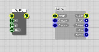

I am trying to load a bitmap, then with X and Y inputs access the pixel at that point, just like the "GetPix" primitive BUT AS FAST AS POSSIBLE.
For one project I need only about 128 x 128 pixel resolution, so at 44100 that allows me to traverse the full array (if needed) in about (128 x 128) / 44100 or 0.4 seconds. But I really only need to access about 2048 pixels per array traverse (random lookup) so that is even faster at about 2048 / 44100 or 0.05 sec (20Hz). Eventually I will get a low resolution video image and look only at certain areas (pixel locations) but I have to do it fast - again "GetPix" is too slow unfortunately
You could even use this to scan a BMP Image out to an RGB LED XY Pixel Array, maybe even with slow video at low resolution - that would be cool to. But that is yet another project...
(For another project I need to access larger resolutions say up to 4096 x 4096, but that is for a different time, much later)
Think of it like Blue (Stream) inputs and outputs instead of Green (GUI Speed) inputs and outputs

Re: Manipulate Bitmap in DSP Code
aronb wrote:I am trying to load a bitmap, then with X and Y inputs access the pixel at that point, just like the "GetPix" primitive BUT AS FAST AS POSSIBLE.
Like this?
@tulamide: very interesting comparison and for me a surprising result! But how do you keep the loop inside Ruby for the task at hand? You would need Ruby commands for getPixel and color2RGBA. Not sure if those are available in FS Ruby?
