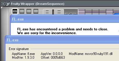

Latest dummy spit for ruby was in Fl Studio, when loading "DreamSequencer" by Nix.
This "DreamSequencer" is a Flowstone modified version.
It also crashed my soundcard in the process(everytime).
billv
