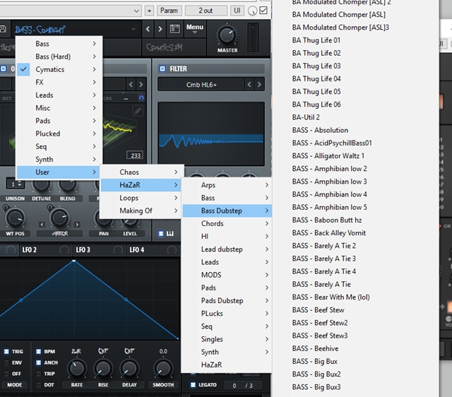

So, say you make a VST with some default presets,this preset manager is set to open a fixed folder User -Documents-VSt-Presets. The user then makes a new preset and saves it , all is fine so far.
But when the user opens up the vst again he is back to only the defaults and none of his own presets.
I realize that you cannot write into the Dll but there must be a way to autoload all presets on startup in the daw ?
Assuming you use a fixed folder.
Also, lets say that you want to use Grouped presets.
Bass
Synth
Fx etc .
And the user might want to add a group , could the preset manager be told that each folder within the specified main folder is a group and then show any additional folders made by the user? And even groups with those groups ?
This is how it works in for example Serum and is very convenient.

Postby Spogg » Sat Oct 20, 2018 9:42 am
I agree that what you would like would be really nice but personally I have no idea how that could be achieved with what we have in FlowStone.
I strongly suspect it’s not possible but if anyone else knows a method please speak up!
Regarding the saving of presets made and modified in the DAW, the project file (song) from the DAW should re-open the presets when reloaded. But the plugin itself won’t retain the new presets. One way round this might be to export the bank as fxb, and then that fxb could be imported into a newly loaded plugin (I haven’t tried this).
