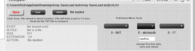

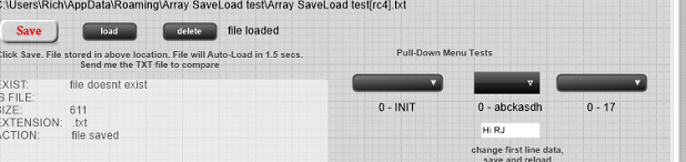

OK ... we got pics !!!
From the 4a test module, my beta-tester sent these Screenshots.
When the test VST is first loaded, this is what's seen:
When the SAVE button is clicked ... he sees this result.
The file is not happening.
After he has tried several times ... it will start to work, and the Saved file will load and populate the menus.
