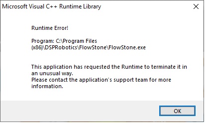

Postby R&R » Wed Jan 11, 2023 10:19 am
:shock: :(
Bummer...
Flowstone crashes when trying to save the .fsm project file.
I think I've encountered some kind of unintentional limit in FS 3.081. Haven't identified what yet. I suspect I am pushing the sizes of the bitmaps in my bitmap prims to much, and this is making FS unstable. Maybe due to memory handing?
There aren't that many bitmap prims, but the bitmaps are large in height (knob strips).
Either that, or I have to much "stuff" in a view, which would make less sense than a bitmap prim problem.
Does FS save a log somewhere?
R&R
Posts: 474
Postby R&R » Wed Jan 11, 2023 10:53 am
Well OK then, Fine!! Too much stuff in a view/module it is!... :lol:
Probably due to one of these causes:
* Too many wireless connectors inside module/at this certain level
* Too many visible graphical elements, iow together with modules+wireless connectors etc
* Slight incompatibility with my graphics? (built in i7 iRIS)
Always happened trying to save file after copying/creating/dragging in "one more" wireless connection, module or prim (don't know which of these action was the cause).
So... this might have to do with graphical handling and... memory involved? I don't really understand why FS crashes just when saving though, but FS might be due for a crash after copying/creating one more "thing"... which only just manifests itself when saving the .fsm file.
Anyway... consolidated and moved some connections/modules inside their own module. Seems to have solved it :? hopefully...

Postby Spogg » Wed Jan 11, 2023 11:13 am
I’m not sure why this is happening but we totally recommend using 3.06 rather than 3.08.1. You might find that if you open the schematic in 3.06 you’ll be fine.
The other thing I should mention is that if you click on the X to close FS, and the schematic has been changed, it’s not a good idea to click on Save at that point. Click on Cancel and save it from the File menu, and then close FS. I found that occasionally the first method would sometimes create a corrupt schematic.
Postby R&R » Wed Jan 11, 2023 11:22 am
I probably should :)
I don't think I've encountered that one :lol: since by habit I only save using Ctrl-S... but very good tip to avoid "Close X and then Save" combination...
