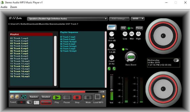

STEREO AUDIO MP3 PLAYER (PICTURE ONLY):
I am still working on this project as it has the following shortcomings (all other items are functioning correctly):
1) No Fast Forward/Reverse.
2) No Skip to Skip songs.
3) No repeat.
It seems that the only way to implement Fast Forward/Reverse is to internally convert the MP3 to a *.wav file?
The interface, well, it is very plain but still practical. There are other settings that cannot be seen on the front panel since it is situated on a sliding window which slides out when a hidden switch on the front panel is activated. The speaker diaphragms do vibrate back and forth in Sync with the music.
NOTE: Long ago Martin was so kind to help me out with the AGC.
Stereo Audio MP3 Music Player-Amplifier v1_010.jpg (62.97 KiB) Viewed 24545 times
