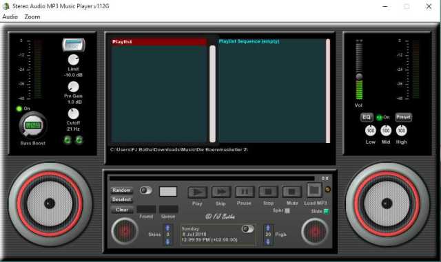

STEREO AUDIO MP3 PLAYER-AMPLIFIER v112G (PICTURE ONLY):
Changed the GUI of the Stereo Audio MP3 Player.
- Stereo Audio MP3 Music Player-Amplifier v112G (Resized).jpg (26.71 KiB) Viewed 22749 times
