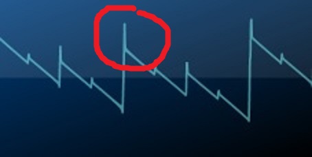

I could use some descriptive parameter naming help...
What would one call this simple subtraction removing the saw but keeping the transient (2 samples)... if it was a knob?
Contains the fundamentals of the saw... but obviously retains HF.
Any suggestions?
Any suggestions?

R&R wrote:I could use some descriptive parameter naming help...
Any suggestions?
Fragmento, fragment or just "slice" maybe...

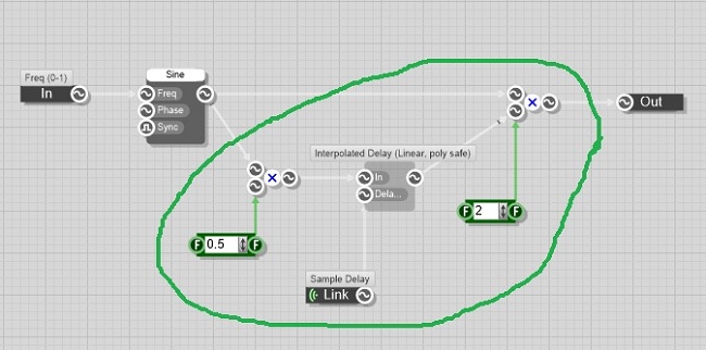

MV if you haven't tired of me completely yet
But someone else might also be able to help me answer this...
Does the parts circled in green cost more or less than a single toolbox sine?
Trying to get some freebies without too much CPU cost.
But can't measure or count operations on a toolbox sine since it's wavetable I guess...

R&R wrote:MV if you haven't tired of me completely yet![]()
Hmmm...
Darn it! Looks like toolbox sine wins this round

Looks like Tepeix delay found here: http://www.dsprobotics.com/support/viewtopic.php?f=4&t=95058&p=237237#p237237 was quite fast... Nice job!
I didn't seem to beat using a second toolbox sine with phase offset in my particular scenario. But is seems slightly faster than MVs variant so it's really useful for the slice.
Don't know if there is a compromise or difference in their outputs (these two interpolated delays)...
