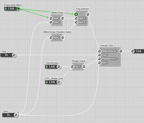

The last fsm you posted looks very much like what I would expect it to look like, but it doesn't seem to work though. It doesn't reset/restart the noise it seems...
Tepeix wrote:But if each channel at the same time, why to reset the random ?
Hardsync via triggerbutton(bool)/automation for use with my LFO
The white noise is actually the source of random number sequences in MV's S&H and glide LFO modules... and maybe other things that it might be used for.

Strange, it reset for me. Maybe it's because of the nature of the sync. (never used this before)
If it's a boolean it might be converted in some way..
MVs_Original_Noise +reset test.fsm- (18.15 KiB) Downloaded 438 times
- Tepeix
- Posts: 361
Re: AHDSR into an AHD
Tepeix wrote:Strange, it reset for me. Maybe it's because of the nature of the sync. (never used this before)
Sorry! you are absolutely correct it does reset
Thank you! Awesome...
This is excellent, now I can focus on the other modules...

I just finished with throwing in MVs Noise (Random) S&H now
Since stage0: doesn't care being fed value at "poly stream start" it seems... I split
the noise into two versions, unfortunately always running at the same time to avoid schematic reloads
I also wanted a mode where seed is fed by note pitch 0-144 but that is probably just as much of a problem as
feeding any other poly to stage0: operations...?
Edit: Maybe the conversion to integer can be done at each sample instead... I'll have to look at it later.
