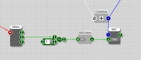

Re: Are my Ruby codes correct?
Here I chopped out the m2f-
but kept the crash->>
(edit-get the testbed a little further in the thread)
The little mod doesn't do anything-
but irrespective of that,
it's something that IMO shouldn't crash by rights.
One example of it's use is an m2f,
a reasonably time accurate stream sampler.
I was looking at your fix,
thanks for the help,
I'll certainly try and make the thing sample accurate,
so the start is peachy,ta
OK,
I removed some components,
and the MIDI out part->
So there are less complications now.
Yeah Bill, Entrancer hangs in alright on it's own,
but if you try and run that sampler conjunctively,
it hangs in Orion anyway.
Thanks for the heads up-that's cool though.
edit-It was crashing in EnergyXT2 too.
But I have found something.
It seems that as long as the code's names are unique,
it doesn't crash.
For example-
initaa
eventaa
in one plug &
initbb
eventbb in the other
hmm-will keep testing
it doesn't crash.
For example-
initaa
eventaa
in one plug &
initbb
