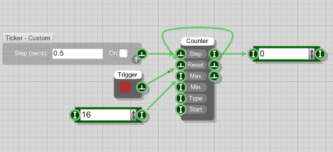

I wonder, what influence has a green counter on the Ruby ticker accuracy?
Can someone answer to this question? Because I'm not sure yet on this issue.
However in my opinion, a green counter should not be influence a Ruby ticker.

Heya Pall!
In my opinion-
Once u have ASIO running the custom ticker will be quite accurate.
The actual Ruby interval should be on the same amount of samples.
So your tick is not bang on the mark because of the green components,
but it will not drift further out in time.
The core of the timer is accurate.
hmm
You could devise a test on rendered audio to see
I have done this with the custom timer and green components,
finding 30 to 150 samples error, it's not the same as ur screeny though
In my opinion-
hmm

nix wrote:tick is not bang on the mark because of the green components,but it will not drift further out in time
Aha...
Thanks Nick!
I will try to do some tests.
Would be nice if someone would make a counter in Ruby.
Cheers!

Hi Pall, good to see you here.
Thats what I'm getting in all my tests. It's bang on the mark and no drift. Everytime.
The pictures of accuracy in hosts are great, but we are not precision watchmakers,
so yeh, it would be nice if Support or someone clarified this.
Nix, can you upload this "test fsm" so I can verify it, and see the error?
I can't help feeling we are maybe "flogging a dead horse" here.
But if Nix thinks there's a error, I'm happy to dig it all up for another Autopsy.
The Logic that we need to do the count in ruby makes sense.
pall wrote: a green counter should not be influence a Ruby ticker.
nix wrote:I have done this with the custom timer and green components,
