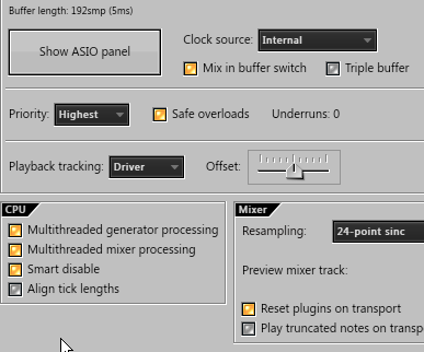

Clearly were not on the same page Myco.
I'm running F11, with these settings
And using your test method....its f**king perfect.
If you don't like my settings, use the exact default settings that appears after install.
And don't muck around with the Fruity wrapper.
So either there's a problem with your settings or....
