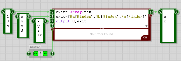

two things array/ruby related

yes you could make an array class methode out of it like this:
you can put this array class methode in a module somewhere in your schematic, but it is important that you do this before adding any other ruby module inside!
then you can use this methode like this in every other ruby module:
ps:if you use my arrayclass methode expansions module you also can add the methode there
