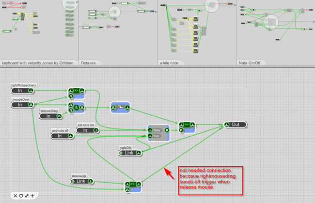

there is a note off triggerconnection from mouseLup which produces a 2nd note off trigger, the note offtrigger is already done by mousedrag which sends a bool to off when release the mousebutton..
don`t know if this also fixes the disappearing gui bug..

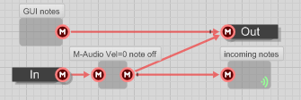

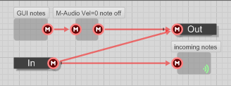

im experiencing some real problems with my midi atm, my rig is not outputing any note off messages, nomatter whether i input midi through my Tascam interface or hook keyboards/synths straight to usb! it is instead giving me a secondary note on with a velocity of 0. bizzare! it seems to have started doing this since i installed a virtual rack software called V-Raxtor, might not be the culprit but its getting the blame ha ha
so i have to use the old M-Audio fix to acheive note off, whitch brings me to this - the MAudio fix is wired incorrectly inside this keyboard module!
Wrong
Correct

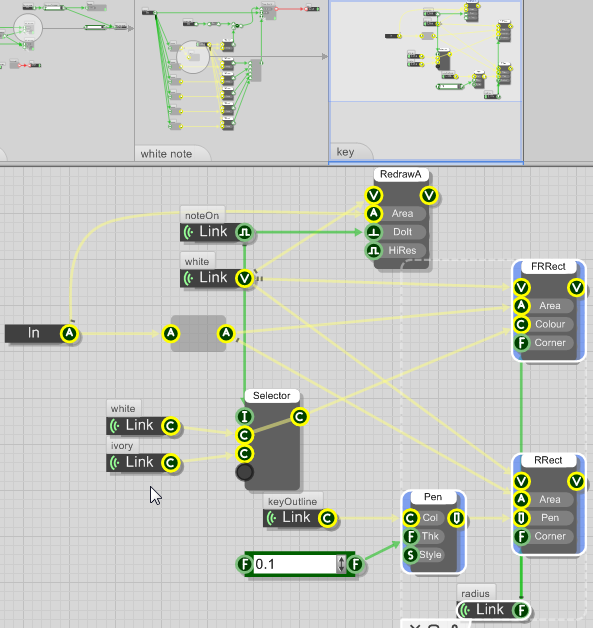

another thing i have noticed is that pressed keys on the GUI keyboard are transparent so there appears to be something wrong with its animation. is anyone else seeing this too?

yes its transparent, someone modified it like this.. in the white key draw part there should be a selector which reacts by note on bool and changes colors between white and ivory.. but you also could just underlay a rectangle with keyboard size and the preferred color, which i think was the plan of the mod..
about the note off message works fine here also without the m-audio mod, anyway in the incoming notes module the note off trigger is also sent when data 2 is zero

is the last fsm with oddsons keyboard where i fixed the double note off trigger bug free now?
because i cannot reproduce the gui bug...
