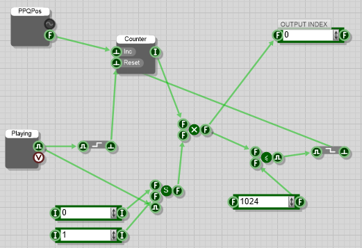

This is the idea I have:
PPQ run at Tempo project (so I guess it is sync enough).
1024 is the max range, than I restart the index (I could set it dynamically if I need less/more samples).
"Playing" will start/reset the index of the array when the DAW start.
I could place a math function to slow down/up the speed of PPQ (so it is not sync with project, but I can choose different ranges) and than (at every OUTPUT INDEX) read the value from the array of samples I've build thanks to the OSC modules (even if I've not idea how to do this in this moment without ruby).
Can't work in this way? Will suffers asynch?

You cannot rely on green calculations for doing anything else than visualisation and slow user inputs. FS allows itself to block green processing whenever it needs a lot of the CPU (so eg. whenever audio chunks are processed). When the CPU is quite busy because of other programs/plugins and FS only has small time slots to do its audio processing, then green calculations can in the worst case get delayed for seconds.
That's like always, if your CPU is busy then the user interface graphics and user inputs get wonky
Although this doesn't happen that often on modern processors...
