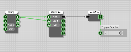

It will suffer only one problems: the number of channels. When I make the path that will be draw, I need to decide if the wave is mono or stereo (because the draw will be different). WaveFile prim will first trigger the mem array prim, than the number of channels. So you have to create the drawing path when you get the number of channels, not the wave. Thus, the "trigger" to draw the new path must go to the Number of Channels connector. But when you re-load the schematic, it triggers only Mem connector (since M2F trigger once loaded), not the number of channels.
i.e. I cannot set two different triggers for the same task (one when I just reload schematic; one when I change to a new sample). Or at least: I don't know how to manage this situation.
This is my actual code (I prefer to stay inside Ruby; as you can see, Mono or Stereo will draw two different kind of Waveform, so I need to know this information before draw it. And this information come to me after Mem, due to how WaveFile output triggers once loaded a wavefile):
Notice the trigger to draw is on "n_channels", which is not called once I load the schematic.
This will also introduce another problem: when you change the sample as VST.
Let say you load SampleA and save the schematic, than export as VST.
When you load, it first will load the wave inside the schematic, and that's ok. If now I change the sample (SampleB) and I store the path to the preset (for reload it next loading), when I reload it will load first the wave inside the schematic, than the sample stored in preset:
If you look at Trigger counter when you load the VST first time (no data in preset), you will see count 1 (the wave stored on schematic when you export as VST).
If you now change the sample (which will store the path to Preset String), save the preset and reload, count is 2 (it first load schematic one, than from VST).
Two times! And this makes trouble, since there are two scenario, where in one you don't have informations about channels, and one with trigger twice and send wave + n of channels.
Is it clear what I mean?

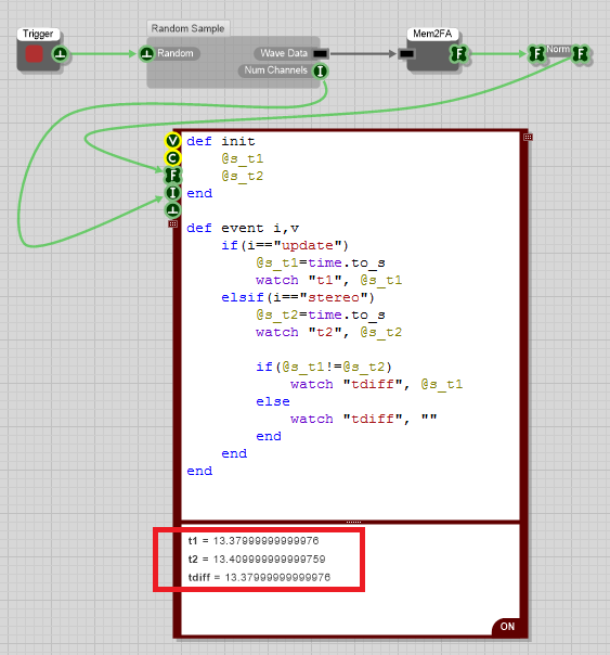

Uhm... I don't understand why you get "update" and "stereo" trigger at the same time:
when :update
getCoordinates
redraw 0
watch "t1", time
when :stereo
watch "t2", time
it prints the same time! In my example instead, update is triggered (sometimes) before stereo, and this is a huge problem, since the "update trigger" will create data to draw where the number of channels is missing.
This is the way I process it:
why this happens "sometimes"? Try clicking on the Trigger many times (10/20 times): at some points you will see the value of tdiff with the value, and if you looks at the times, they are different (looks at the pic). I don't know where the issue born...
Maybe it process "[F]" (update) at different ticks of I (stereo) in Ruby's event stack? So that difference in time? How can I fix this? Double flag?
(note you need to put some samples path inside the array to switch random to them and looks at the results. Try with samples with huge size for better results)

there are two ways to fix this, program the wavedrawer in a way where it doesn't matter what the stereo flag says, or if you are sure that it is a timing thing you can sample and hold the wave and give it free after the channels are setted
so the first connection of the channels output goes to your ruby wavedrawer and the second triggers the sample and hold to send the wavefile to the wavedrawer...
Re: Render a View to a Bitmap - Some questions
Nubeat7 wrote:there are two ways to fix this, program the wavedrawer in a way where it doesn't matter what the stereo flag says
Nubeat7 wrote:so the first connection of the channels output goes to your ruby wavedrawer and the second triggers the sample and hold to send the wavefile to the wavedrawer...
Sure
Also, it's strange enough that Mem (which takes couble of ms to read/send [F] to Ruby) happens at the same time of Number of Channels trigger (when they happens together). Or is it the time Ruby will read from connector at fixed tick?
I thought that once Ruby reach a trigger, it just process the event one after one. But it seems it stacks them and process at fixed tick (I guess; it is not written in manual, I don't find this information).

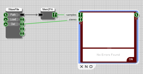

Yes I've thought about it, but I don't know if that's the right choice.
What's the best approch in this case? Invoke the drawing on "stereo" connector and set an After Load to it?
Because my worry (since I don't get how Ruby schedule the events) is that can also happens that "stereo" will be triggered before "samples".
In few words: is it possible that WaveFile's final destination trigger is "stereo" before "samples"?

You said you are a programmer, and mentioned C sharp. But all your question tell me that you never before programmed in an object oriented, event driven, multi-tasking, multi-threaded, multi-core environment.
So let me point out: You may never rely on anything! Don't assume an order, in which events will be triggered. Don't try to force or prevent a redrawing. Don't try to do that 30 year old, static top to bottom executed code. That doesn't work in modern programming languages.
For example, there's a method that's executed on an event. You have multiple inputs that can cause the event method to execute. Therefore it's your responsibility to create code that deals with each possible scenario of events. If you want to first evaluate "stereo" before "samples", program it that way. Wait until both triggers happened, then execute your branch of code that deals with mono or stereo, depending on the stereo tigger.
def event i, v
if i == "samples"
@triggers = @triggers | 1
elsif i == "stereo"
@triggers = @triggers | 2
if @triggers & 3 == 3
#now both triggers happened, both data are available
#...do whatever code
@triggers = 0
