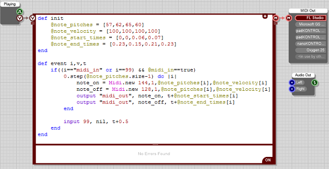

Let say I ignore for now to understand "how things are programmed inside FlowStone". I still really don't know where I am wrong here, because I'm not able to keep sync Ruby timing with MIDI that will be trasmitted (outputted) to the DAW (FL Studio). Ruby Code is very basic:
where midi_in is a bool and midi_out a MIDI connector linked to a MIDI Out prim (which output MIDI to FL Studio). Once I trigger the bool, it sends 4 MIDI notes to DAW that play (each) a simple sine wave within a plugin (Sytrus in my example).
If I record some shoots of these 4-note-score provided by the script above and I play together two of them (one with polarity reversed) I don't get a NULL test: I hear a bit of audio. They are quite similar, yes: but they must be "equal".
Thus, I'm not able to sync MIDI with Ruby timing, or I don't know what I'm missing. Any clues?
def event i,v,t
if(i=="midi_in" && @midi_in==true)
setupMIDI
0.step(@note_pitches.size-1) do |i|
note_on = Midi.new 144,1,@note_pitches[i],@note_velocity[i]
note_off = Midi.new 128,1,@note_pitches[i],@note_velocity[i]
output "midi_out", note_on, t+@note_start_times[i]
output "midi_out", note_off, t+@note_end_times[i]
def setupMIDI
@note_pitches = [57,62,65,60]
@note_velocity = [100,100,100,100]
@note_start_times = [0,0,0.06,0.07]
@note_end_times = [0.23,0.15,0.21,0.23]

For help the "investigation", here's two example!
One for FL Studio owner (basic Patcher with Sytrus and no addittional plugins):
and the same schematic that works in FlowStone standalone (which will play/send MIDI to Microsoft GS Wavetable):
both are out of sync during playing (press play on FL Studio or switch the boolean to True in the schematic). Or I am wrong in some places or FlowStone/Ruby can't sync MIDI properly
