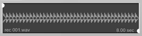

Here is the null->
original->
original->
Re: how to send Midi Message
nix wrote:Here is the null->
Thats not null
Can you post please to me that module to check "null"? So I wont use FL for tests...
- Nowhk
- Posts: 275

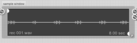

it's not user friendly,
just a quick sampler mod
Yeah- something's up, it is very close though and almost cyclical

Nowhk wrote:Check this schematic (or directly the FL12 project) in your DAW (there is a Playing prim):
Your schematic once again tries to take over control against the DAW. As long as you try that, you will have issues.
(1) You are not sync'ing at input, you are just asking if the DAW is playing.
-> You should have asked if there is a midi note incoming.
(2) You are not sync'ing to PPQ, instead you just sync'ing to time.
-> You need to sync to PPQ
(3) You don't use frame sync, which is what the outputs (here DS Out) are using. A frame is the buffer, to which all audio data is written.
-> Use frame sync
If you do all three, you are sample precise in sync (minus all imprecisions that may be introduced by the DAW).
