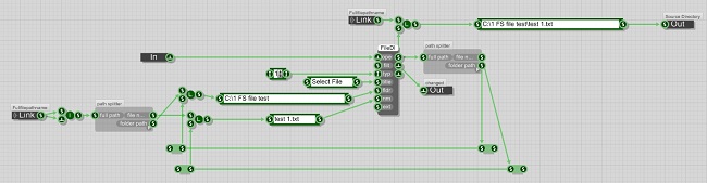

OK ... in the never ending quest
I could use some guidance/critique if this is a proper technique.
Here goes. In supplying SAVED file PATHS back into the FILEDIALOG prim ... like this:
Is this the best way to get PATHS that is saved/loaded from a TXT file, back into the FileDialog to set a default ?
Obviously ... asking because this seems like it should work ... but it ain't really
Thanks for any help.
Here's the sample schematic:
Re: Default Directory locations
Gee ... not even a reply
Not even, 'that's the ugliest schematic ever seen !' .... just terrible ! .... nothing ?

Hi Tronic.
I don't want to sound ungrateful, and already know You are way more experienced/knowledgeable in programming ...
But I'm hesitant to be writing into the REGISTRY. [even if that's whats happening when using some PRIMS and other FS functions]. Yeah ... you can say I'm chicken
Maybe there is no other way. I've tried many things [even with my limits], and nothing has worked consistently, and more times than not, my attempts just fail.
For some reason, the FileDialog PRIM just doesn't seem to use the 'default location' connector properly, or I'm doing something totally wrong in the sample schematic I posted above.
A solution I would prefer ... could this been done using RUBY ? Basically replacing the FileDialog PRIM with a RUBY routine ?
Again ... please don't take this wrong.

Guys ... the schematic example was just that ...
The WIRELESS connectors are from a SAVE/LOAD module [very standard text file]. I just didn't include that to keep the post simple.

Don't feel offended, RJ, but for me the whole page 3 doesn't make much sense.
You post a low res image of just a part of the whole system that works together. And when it comes to the point, where you would like to get some help you say: "It ain't really working."
That's nothing I would waste my time on.
(1) Post a schematic that clearly shows the issue(s)
(2) Describe in detail, what you expect that schematic to do, and what is not working correctly.
To the point, and with as much information as needed, then you might get more help.

...only mention again like tulamide and i did before:
get rid of the loop back folder splitter (including the 4 nodes)
and it should work...!
1st trigger the ini load
2nd open file dialog
3rd if done save ini...
Keep on doing!
Keep on doing!
