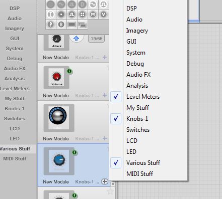

I created a schematic with a few knobs in SynthMaker, I open that schematic , add the knobs into FlowStones toobox Under the "Knobs-1". After a flowStone Re-Start now my knobs are in Various Stuff and Level Meters.. How can it do that when I added the knobs directly from a schematic ???

ok so now we know that there is some funky bug in the tagging system.. I'm SO ready to purchase FlowStone 3 with the 12 months updates but we need to get the toolbox fixed

I think I have an idea why this is happening. The tag mappings are stored in the Tags folder under FlowStone in App Data (parallel to the modules folder). For modules these mappings are based on the module name. The idea was that you might want to swap a set of tags for another and that you could do that simply by swapping the files. For this to work, mapping by name was the only real way to do it.
What we've just noticed from your posts above is that the downside of this is if you add modules which have the same name. In that case the tags get merged and this is why you are getting the tags muddled up (above they all get the default name New Module because no name is specified).
If your modules have unique names this won't happen.
So clearly we need to sort this. We were on the verge of the first update so we'll get this sorted for that release. Sorry for any convenience caused.
Just one last point. In SM, with the filter groups the group name was stored with the module. This meant that if you moved the module it would retain the name. However, to change the group you had to delete the module and then re-add it under a different filter group. It's this group that is used as a tag when you copy .hom files over. No other text form inside the .hom is picked up. I can see why you might have speculated that this was the case but it's not what's happening.

IT WORKS !!!! no problems with the toolbox if I make sure to have a a descriptive name for each of my Modules
Thanks Admin....
