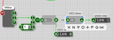

Postby billv » Sun Apr 07, 2013 12:05 pm
Note the ticker is not active. What is it for?
I didn't get it, so i deleted it.
Re-tested in Live. same thing.
Take another look after work tommorrow........

Postby nix » Sun Apr 07, 2013 12:15 pm
ta for having a look
In that schematic, the example synth--
it doesn't do anything,
just makes Orion crash.
You could hook it up to a trigger counter to see if it is going.

Postby billv » Sun Apr 07, 2013 8:31 pm
nix wrote:In that schematic, the example synth-
Nix, The picture I took was from the Sampler ...... Not the example synth....

Postby nix » Tue Apr 09, 2013 8:39 am
hmm,
maybe u r not getting the crash coz u took it out.
The timer is the module that causes the crash.
RDSP has reproduced the crash.
I'm fuffing about with 2 ticker methods now.
I'll work on DreamSequence soon.
We can communicate beteween Ruby modules with MIDI links,
like say the note goes beyond 127-
so we can have a sequencer with more than 128 steps over MIDI link.
I had unhooked the timer,
trying to locate the component causing the crash.
That timer gives a tick to the m2f in mod,
which translates the stream into green,
which triggers the random step LFO changing to a new random array, and updates accordingly in the graphic.
