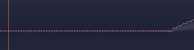

So here is the real story.
this is my timer at the very last sample before display dissappears
And here it is all the way
And here is Stock VSTi. Look how far out it is...
- Posts: 1164

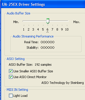

Just a hunch...
Is that delay pretty much the same every time?
Is your soundcard set to use a 64 sample buffer?
Re: Stock VSTi Fails Timing Test Using Host Seq
trogluddite wrote:s that delay pretty much the same every time
No, the drift amounts are always different.
trogluddite wrote:Is your soundcard set to use a 64 sample buffer
Tried pushing the slider to min, gets me 94.
Do I have to be at 64?
What are the ramifications here?

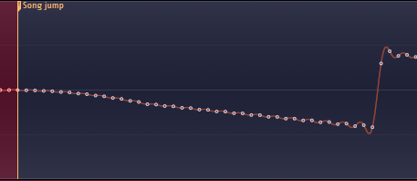

Using the voices module in FL FS, instead of the midi to poly...
all good, definate movement at the very start.
So again, this is telling me the "Midi to poly" module is faulty and
Needs to be fixed to get an accurate Polarity test result....
To clarify,
Using Voices module in FLFS is picture above...
Using Midi to Poly picture below...
My cowboy fix attempts are not fixing the issue.
