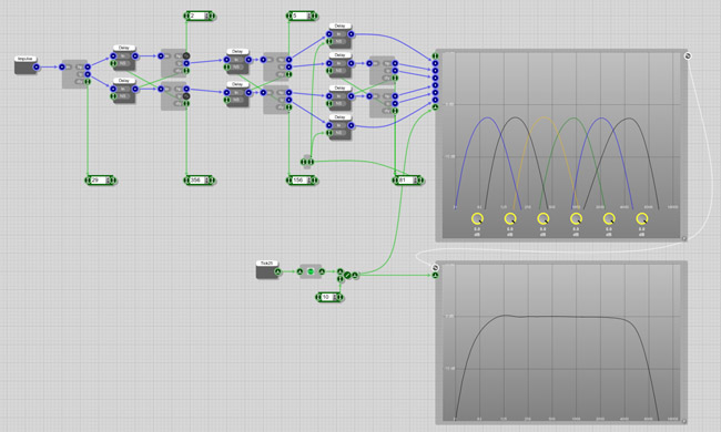

What if opting for a phase-linear 6-band splitter, costing almost the same CPU% than a 4th-order Linkwitz-Riley one (that's not phase-linear)?
See it here:
Have a nice day
See it here:
Have a nice day

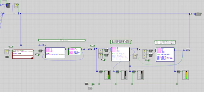

What if opting for a compressor-limiter, per channel, that's embedding the channel gain control?
Have a nice day
Have a nice day

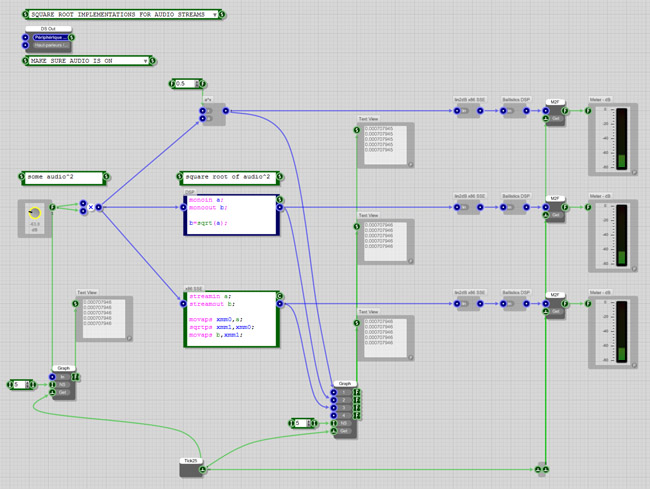

I understand the audiophile preoccupation of managing the compressor-limiter side-chain in dB domain instead of in LINear domain. Unfortunately, the lin2db block and dB2lin block appear to be CPU% hungry. Times six, in case there are six channels.
There exist various analog audio compressors-limiters, that are managing the gain (attenuation) in various unspecified domains defined by some vacuum tube in low V anode-cathode region, some JFET in low VDS region, some BJT in low VCE region, some vactrol (LED + LDR), etc. all recognized as working satisfactory. All providing transfer curves lying between "log(x)" and "sqrt(x)".
Speaking of digital, why not trying the sqrt(x) domain?
I am making such proposition, because the Flowstone Assembly Code component supports the x86 sqrtps xmm1,xmm0; instruction, much faster than a lin2db block. Consequently, the side-chain can manage the gain (attenuation) in sqrt(x) domain. At the beginning of the side chain, instead of placing a lin2db block, we place a sqrt(x) block, much faster than a lin2db block. At the end of the side chain, instead of placing a db2lin block, we place a x^2 block, much faster than a db2lin block.
I am attaching a .fsm, showing the validity and precision of the x86 sqrtps xmm1,xmm0; instruction.
Have a nice day
Have a nice day
