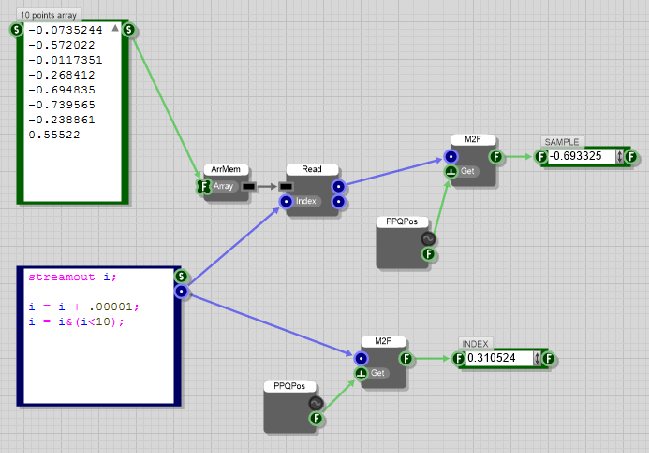

Anyway I think I'm making some other mistakes:
Without rely on Graph (I removed it; could be delayed as suggested), every time an integer in INDEX module is outputted, I should immediatly see the current sample of that index changing in the other SAMPLE module.
Instead they are way (waayy) to async. What am I missing dudes? Its somethings like 3/4 seconds delayed. Too heavy...
can't figure it out!
I guess that:
when i==0 output => -0.693325
when i==1 output => 0.755871
and so on. Instead it "change" around i=1.78 for example, and the first step is quicker than the others (i=1 happens quickly).

can I get the whole LFO schematic?
Do you need to use ppq?
ps- when you use .00001 as the counter iter,
it takes very long to count to 1, which is where it will register an integer step in the wave read

Uhm, I don't understand your schematic: it's identical to mine! And in fact using "i + .00001" I've the same problem.
