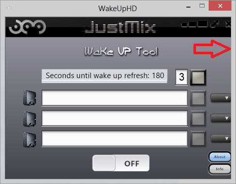

Ooops - overlooked this bug:
One grid is missing vertical on the right Border and horiz. at the bottom in Focus Mode and on the right in EXE's

Postby MyCo » Wed Dec 09, 2015 12:07 am
hehehe, funny thing... we noticed it too, and are already investigating
