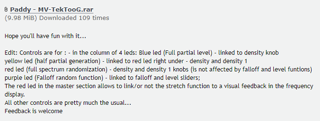

Hey,
Here is my take on it
I based the partials generation on an advanced random module...
Partials spectrum shape is draw-able also.
If this is at people's taste, I'll keep on going with it too... I still have a few ideas that could make that little thing a real padding beast!
you can count me in!
Hope you'll have fun with it...
Edit: Controls are for : - in the column of 4 leds: Blue led (Full partial level) - linked to density knob
yellow led (half partial generation) - linked to red led right under - density and density 1
red led (full spectrum randomization) - density and density 1 knobs (is not affected by falloff and level funtions)
purple led (Falloff random function) - linked to falloff and level sliders;
The red led in the master section allows to link/or not the stretch function to a visual feedback in the frequency display.
All other controls are pretty much the usual...
Feedback is welcome
