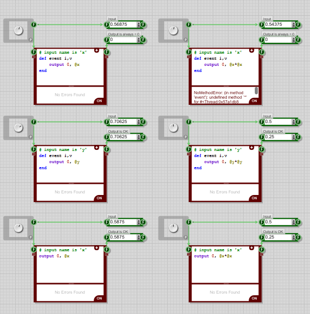

Ruby event Method does not work with input labeled 'x'
This simple piece of Ruby code won't work:
Output is always zero, and there might be an error message or not. It seems to work with input names other than 'x'.
# input name is 'x'
def event i,v
output 0, @x
RubyName_x_Bug.fsm- (7.88 KiB) Downloaded 1166 times
Re: FlowStone 3.0.8 SKYLARK(any bugs or issues)
looks like @x is used by FS as a variable to store the main Ruby Thread... that's a bit stupid though.
