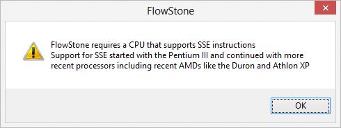

BUG: Touch-Screen R-Click simulation on EXE Compiled GUI and in FS... v309b1 disables this feature...
P.S.: 309b1 FSM's are not loadable in 3081
even wo new prim)
Press and hold does the same thing as right-clicking an item. To perform the action, touch the screen where you want to right-click, hold until a box appears, and then lift your finger. The shortcut menu appears after you lift your finger.

Walter Sommerfeld wrote:BUG: Touch-Screen R-Click simulation on EXE Compiled GUI and in FS... v309b1 disables this feature...
I don't think FS can disable that in any way (as it just sees a right click). Else all I can say is that the right click behaviour wasn't changed at all in this version.
Walter Sommerfeld wrote:P.S.: 309b1 FSM's are not loadable in 3081even wo new prim)
Yes, forgot to mention. The saved files are not downward compatible due to the new assembler and the editor features (eg. bookmarks).
