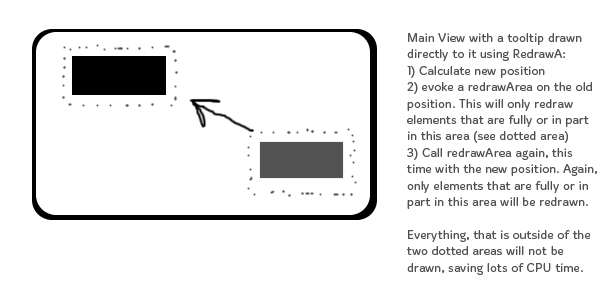

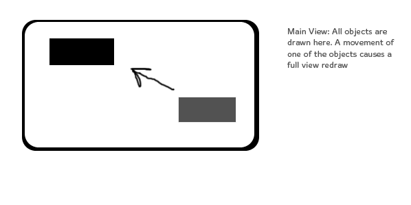

There might be a misunderstanding of the concept. To make absolutely sure we talk about the same, I made two (artistically impressive
) images:
Of course, that's just the theory. If Flowstone has this programmed badly, it won't result in more CPU time. But that's needed to be tested.
