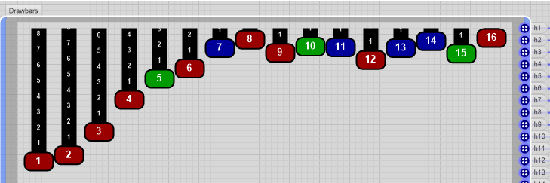

Nothing much to show yet, apart from a visual clue :
Red drawbars will be played by the 'Unison' generator set, green by the '5th-tuned' generator, and blue by the '7th-tuned' gen. Just 16 at this stage, to try and prove the principle. (Many more greens and blues higher up).
And so far I've successfully managed to decipher MV's ingeneous masking process and made the 9th harmonic drawbar work correctly. Hey, it's a start
