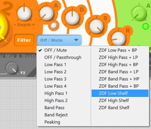

Looking at finding some additional use of MVs ZDFs in my plugin. Maybe they can act as crude EQs if my synths F2-filter is unselected/free for use... Since I won't be adding a dedicated FX or EQ section to the plugin. Too advanced for me...
Super efficient low/high shelfs by just adding outputs together?
Anyone know if I can sqeeze a little extra (due to being 2nd order) out of the ZDF's by overshooting cutoffs?
Iow is it safe to feed a cutoff slightly larger than 1 into these ZDF's? They go bananas at around 1.04< and then cuts out. Some kind of denormalization or a more regular division issue dependant of a given samplerate perhaps?
Math looks straight forward when looking at MVs original DSPs, but still I have no clue... Math
Like "gazing into the void beyond" for me
I only need to feed a cutoff of <1.03, but don't know if it might break for some reason.

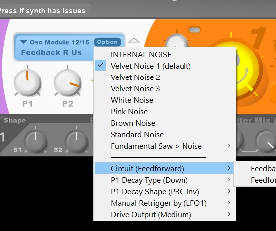

Jumping between threads...
just like I've broken my own original plan a whole lot by adding the option-dropdown to begin with.
What a letdown!
Might as well keep going.
Still not sure about naming...
The "P1 Decay..." dropdown-items? Should I call it decay, strike or exciter? It's just an oscillator for a (decay or gated) burst to get a feedback loop ringing.
Just by this screenshot what would be the most clear naming, for drawing "an only visual" conclusion of what the function is...?
What a letdown!
