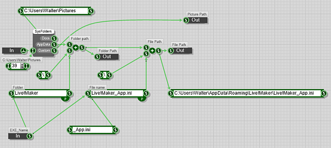

Demanded via PM by RJHollins here my solution capture:
btw: i use Trogs Custom Seetings File manager (with little FS Trigger changed bugs) with it...
Win8(6) i7 Quad
Walter
Walters Sysfolders.png (93.16 KiB) Viewed 15983 times

Something very interesting with the schematic you've posted, particularly the TRIGGER INPUT on the SYSFOLDER prim. Maybe someone would explain why this is added :?:
My schematic section in this area looks nearly identical ... heck, I probably saw you posting at the SM forum and modelled accordingly :lol:
