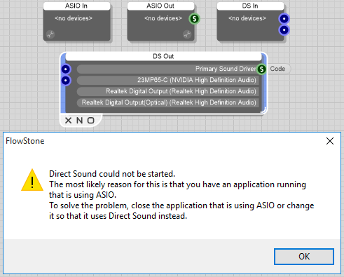

Driver problem in Win-10, here no Asio driver present and any other app started.
Maybe not work whit Nvidia audio driver?
Anyone?
Anyone?

Maybe a compatibility issue? Direct Sound belongs to DirectX. And there's an all new version of DirectX (v12). Or the drivers are not updated to work with DX12.
Re: FlowStone 3.0.8 SKYLARK(any bugs or issues)
For Asio... are you sure you have a 32Bit ASIO Driver for your soundcard?
For DX: If I remember correctly, I had a similar issue with Win10. You can fix it by changing the settings of the soundcard in the windows control panels. Not sure about that, but I think it was something like checking/unchecking "exclusive control" and you might have to turn off the audio enhancements that you can find in the same dialog window (different tab) if it is supported. I played with these settings a lot, and after a restart the problem is gone.

Thanks for the suggestions,
tried various settings for the options you suggested, but it still does not work, regarding the ASIO driver on this machine I have no additional sound card, only those integrated into matherboard and Nvidia video card, so I really do not understand the message error returned.
