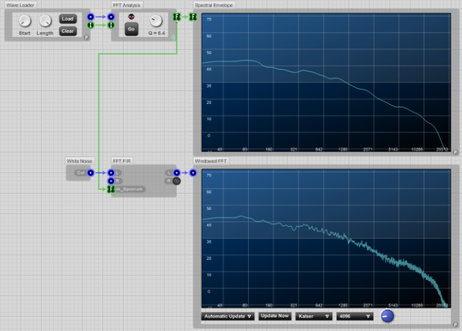

Spectral Envelope Cloner
I think I finally found a way to clone the spectral envelope of an entire track onto another source - white noise in the example, however it is possible to "whiten" an arbitrary track by dividing through its own spectral envelope. Both the analysis and the filtering is FFT based, with an option to smear the (unwanted) high frequency resolution to obtain constant Q. The Q is freely adjustable as a post process once the spectral envelope is captured.
The filter is an FFT linear phase FIR which is a desirable property for mastering (so I am told). I haven't implemented it as a zero latency partitioned convolution here, although it could be done for real time scenarios.

Martin ... this is really something, but I do need to ask/check on one thing ...
I'm looking inside the 'FFT FIR' module.
In the 'FastUnpack (unmasked)' module, the L/R output links ... are these in the correct position [1 & 4] ?
I would have thought connection 1 & 3 ... but not clear why.
Thank-you for any clarification !

It's a bit tricky.. I'll upload a stereo version later.

I'm glad I asked first.
I've been doing several testing with very positive results. Very solid.
It takes [maybe 10 secs] to scan an audio track and post a 4096 data point output/display.
I've added some extra features as I've scan 7 tracks to be used as separate presets. Easily can switch between the spectral presets. very solid.
side note: It is quite interesting to listen to the white noise filtered through these spectral envelopes. You can actually sense the balance, energy, attitude, and the overall sound-stage of the original track.
This is exactly what I had hope to have ... a single snapshot that holds the original audios energy AND presentation.
This looks to be a specially 'focused', calibration tool. Granted, this is but one piece of the overall strategy/goal ... but it's a critical starting point for the process.
It's almost like we now have the laser-beam coherently focused, and now the test/experiments can begin.
Martin ... this is very special what you have designed. There are a few 'internal' settings that are hidden inside that I'm going to be looking into, but I may need to ask for additional information/explanation to realize their impact.

Thanks for the kudos!
Here you go stereo cloner.
