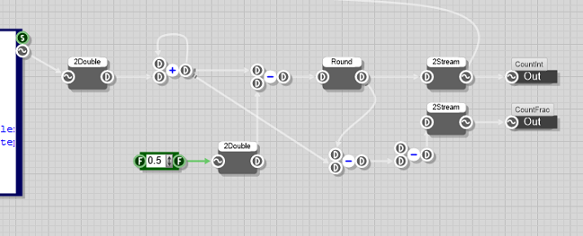

Looks at the Precise Counter module inside it:
if you play the sample at original pitch (step=1 from DSP code), the value of CountInt (which is the index of the sample that will be read by the following Interpolation module; to be precise, that value-1 since is zero-based) will never get odd values
Out of DSP Code (step=1):
First iteration: 1+0 (feedback prim), than 0.5 (-0.5), than Round... CountInt=0
Second iteration: 1+1 (feedback prim), than 1.5 (-0.5), than Round... CountInt=2 (BUG)
Third iteration: 1+2 (feedback prim), than 2.5 (-0.5), than Round... CountInt=2
Fourth iteration: 1+3 (feedback prim), than 3.5 (-0.5), than Round... CountInt=4 (BUG)
and so on...
The odd values will never be considered. But it seems that the sample play fine. How can play fine if odd index (reading the wave loaded in memory) will be ignored?

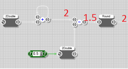

Real debug values (I guess
Play a note: it outputs 0 (on Round Primitive(0.5) Poly readout) and 2 (on Round Primitive(2.5) Poly readout), not 1 and 3.

Yes, Tie-breaking: "Rounding a number y to the nearest integer requires some tie-breaking rule for those cases when y is exactly half-way between two integers — that is, when the fraction part of y is exactly 0.5."
I can have part of y when it's exactly 0.5 in the example: after it get feedback of itself (let say 2), 0.5 is subtracted; thus 1.5 after Round should be 1, not 2:
I'm missing all odd values, since all input is an integer (playing sample at original pitch) less 0.5, in a range between 0 and wavefile size.

But it works out perfectly, see:
CountInt = round(Input - 0.5)
Input is 2, that means CountInt = round(2 - 0.5) = 2
CountFrac is Input - CountInt, which is 2 - 2 = 0.
WavePlayer always reads (1.0-CountFrac) * sample[CountInt] + CountFrac * sample[CountInt+1]
(simple linear interpolation)
which in this example turns out to be:
(1.0 - 0.0) * sample[2] + 0.0 * sample[3] = sample[2]
which is exactly what it should be.
Now try with Input = 3 (odd number)
CountInt = round(3 - 0.5) = 2
CountFrac = 3 - 2 = 1
(1.0 - 1.0) * sample[2] + 1.0 * sample[3] = sample[3]
works exactly like it's supposed to.
