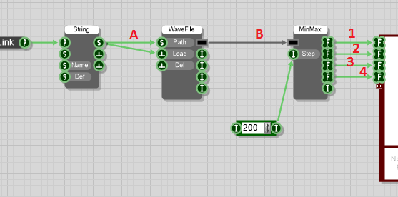

I don't think the outputs marked '1,2,3,4' should be considered separately. They are of the PRIM.
What happens after those outputs then depends on the circuit path from there.

RJHollins wrote:I don't think the outputs marked '1,2,3,4' should be considered separately. They are of the PRIM.

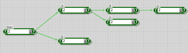

Not sure if I got correctly your words. With a more easy example:
here it's not possible that (when I change Float Start), Float E data get updated before all A/B/C/D Floats get updated. Can you confirm this? (and save my life
here it's not possible that (when I change Float Start), Float E data get updated before all A/B/C/D Floats get updated. Can you confirm this? (and save my life)
alright ... I'll take a stab at this. From my understanding/experience dealing with trigger ORDER [not so much TIMING, which I would say coding something THAT specific would be logically better handled/controlled in RUBY code] ...
From [START] -> trigger FIRST to A, then E [looking at the black marker coming off [START].
[A] triggers [B], then [D] ... then [C].
The UNKNOWN .... how FAST does the trigger pass from [START] to [FINISH].
I suppose a 'timing' analysis module [from one of the toolboxes] would provide a milli-second readout of that.
NEXT ... I believe what the GURU's here have tried to impress, is the overall construction of a schematic IMPACTS how this all works.
A small, isolated example MAY reveal a particular result ... but within the context of a specific schematic, with function and design that only the author sees/knows .. what can anyone say ... Your Mileage MAY very.
This may be viewed as a problem. It is nothing less then the 'timing jitter' we saw in early PC MIDI apps. The ATARI STe computer, with a dedicated MIDI communication port/architecture was specifically designed to do one thing ... handle MIDI data.
GREEN timing is loose ... we know this ... it will probably stay that way. [unless one wants to 'fix' the computer and OP system]. There are other methods, including with FlowStone. Coding with RUBY, or DSP. Care must be exercised in planting THOSE 2 elements into a GREEN environment.
This is my understanding. The gentlemen who have spoke about this here have much more experience/knowledge regarding this topic ... and more.

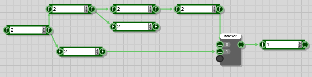

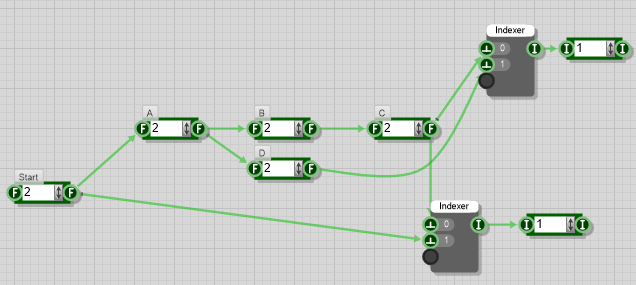

RJHollins wrote:From [START] -> trigger FIRST to A, then E [looking at the black marker coming off [START].
No man. Its not Start->A, START->E, A->B, A->D, B->C.
It's Start->A, A->B, B->C, A->D, Start->E. This remove the dubt I guess:
since I've removed Float E and link Start (tick 1) directly to the Indexer (which is still the last to be triggered).

From [START] you have 2 triggers.
The first path is to A
the second to E.
