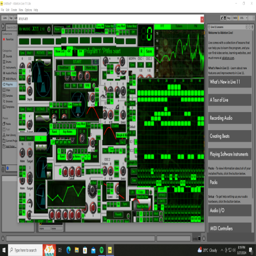

In Abelton Live, the graphics are completly F**ked so it's un-useable

billv wrote:In Abelton Live, the graphics are completly F**ked so it's un-useable
In Fl Studio, has the worst result, where the plugins don't show up at all, not even in the browser.
Curious... What happens to the plugin-graphics in the DAW's that actually manage to load the plugins?
Do you have a screenshot?

R&R wrote:Curious... What happens to the plugin-graphics in the DAW's that actually manage to load the plugins?

billv wrote:R&R wrote:Curious... What happens to the plugin-graphics in the DAW's that actually manage to load the plugins?
Looks like drawing origins are all over the place somehow

In abelton live, in the Options/preferences/Look and Feel.... they have a button that's dedicated
to screwing with the graphics.: HiDPI Mode....turn this off....and problem FIXED.
