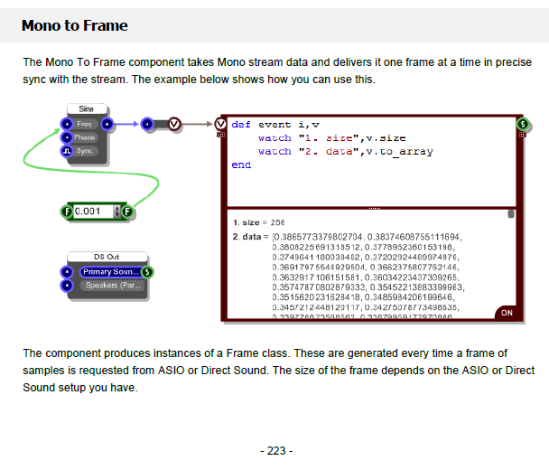

the Mono to Frame prim seems to have an issue. I am experiencing random crashes with the schematic on page 223 of the manual (see below) when I switch off stream processing.
It happens with any of Direct Sound, ASIO4ALL or the ASIO driver of my adapter.
It happens with FS 3.0.8.1, FS 3.0.9 Beta, and FS 3.0.9 Beta2.
Anything you can do about it? Many thanks.

@Martin: I'll have a look... but I guess it's one of those problems that depend on the system (As I would have noticed that before)

My system is Win 7 Home Premium SP1, 64 Bit, Athlon II X4 640 if that is of any help at all.
Re: FlowStone 3.0.9 Beta2
Postby MyCo » Thu Aug 18, 2016 8:17 pm
I can reproduce the problem... it looks like a deadlock of something, quite hard to figure out what's actually causing this
