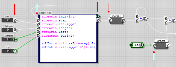

Here's an issue found in the display of single streams, which in some cases are being incorrectly represented on screen by double stream icons (see the red arrows):
Last edited by TheAudiophileDutchman on Sun Dec 20, 2015 5:30 pm, edited 1 time in total.
